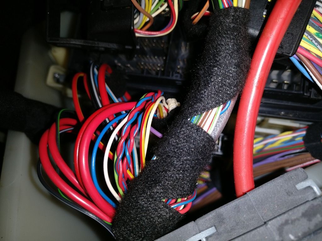

I am working on installing my JB4, but ran into a couple of discrepancies.
First, the installation instructions state to install the Green and Purple fuel wire pairs, which my JB4 doesn't have any purple and green female/male wire pairs. I do, however, have some black and brown wire pairs. How should I install these? Do they take the place of the purple/green? If so, which color goes where?
Secondly, I see two pairs of red and blue wires where the CAN bus wires are. Which ones do I install the JB4 green and brown wires to?
(#248)
Posts: 34,196
Default 06-17-2017, 06:04 PM
Skip the dme wires and install tmap and obdii only to start. The fuel wires are only required for some higher boost applications. But we were out of stock on purple and green wires so used black and brown, respectively.
