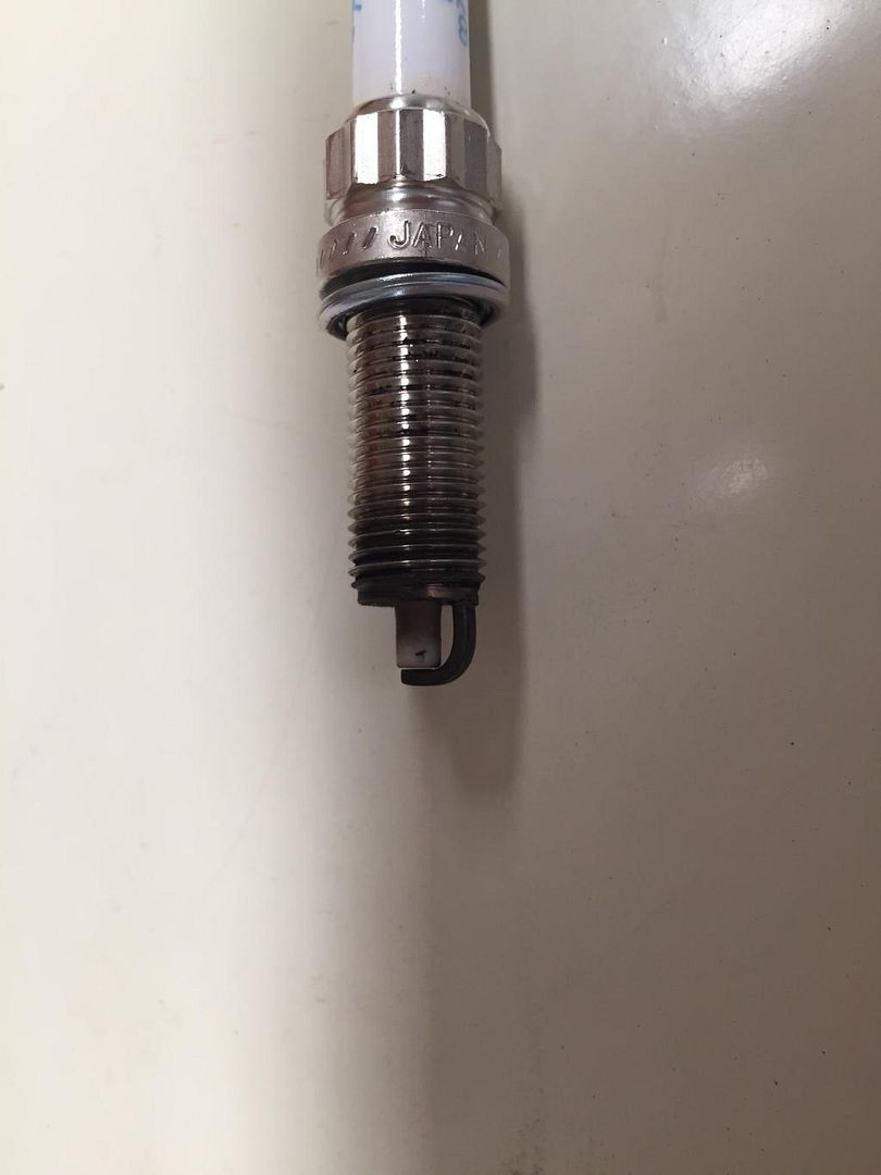

Default NGK's Okay - 04-24-2017, 06:11 AM
I was reading through this thread because I was getting ready to replace the NGK 95770 plugs that I gapped to the recommended (by Terry) 0.022" when I installed them 56,000(!) miles ago and I was nearing the 60K CBM recommended replacement interval. I have not had a misfire on this set of plugs (and ignition coils) for all of those miles with the JB4 on maps 1 and 5.
Many of those miles were covered while driving with the cruise control on or in stop and go traffic during my 90-mile round trip to work each day. I mention that because there are limited opportunities in heavy traffic where I can watch the fuel come boost gauge show the JB4-enabled 15 psig that makes this engine so much fun.
During installation, I was careful when setting the gap to not damage the iridium "dots" on the plug tips and handled them like $13-a-piece jewelry to ensure that they were installed in good condition. I have had only positive experience with the NGK plugs in the N54/JB4 combination.
On the other hand, with the OEM Bosch plugs, I have had short-lived (20K) life spans before notable misfires under heavy boost.
